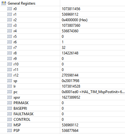

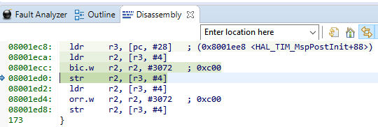

2018-03-14 1:31 AM
Ok
meyer.frank
I stepped up until the line it crashes and copied the asm and register state, as below in the screenshots:This appears to be when the code is writing the flags back to the register with the following line (expanded from the macro):
CLEAR_BIT(AFIO->MAPR, AFIO_MAPR_TIM3_REMAP);
2018-03-14 1:43 AM
Dunno why Eclipse (TrueStudio) has integer format view for registers as default ... R3 equals to 0x40010000 at that time.
I don't know the memory map of your device by heart, so can you check if this address is valid, and makes sense in this context ?
Register addresses are listed in the Reference Manual.
If the address is valid, the clock of the peripheral you trying to access might not be enabled. Cube is said to contain some bugs.
Does TrueStudio's 'Fault Analyzer View', as seen in you screenshot, has anything useful to say ?
