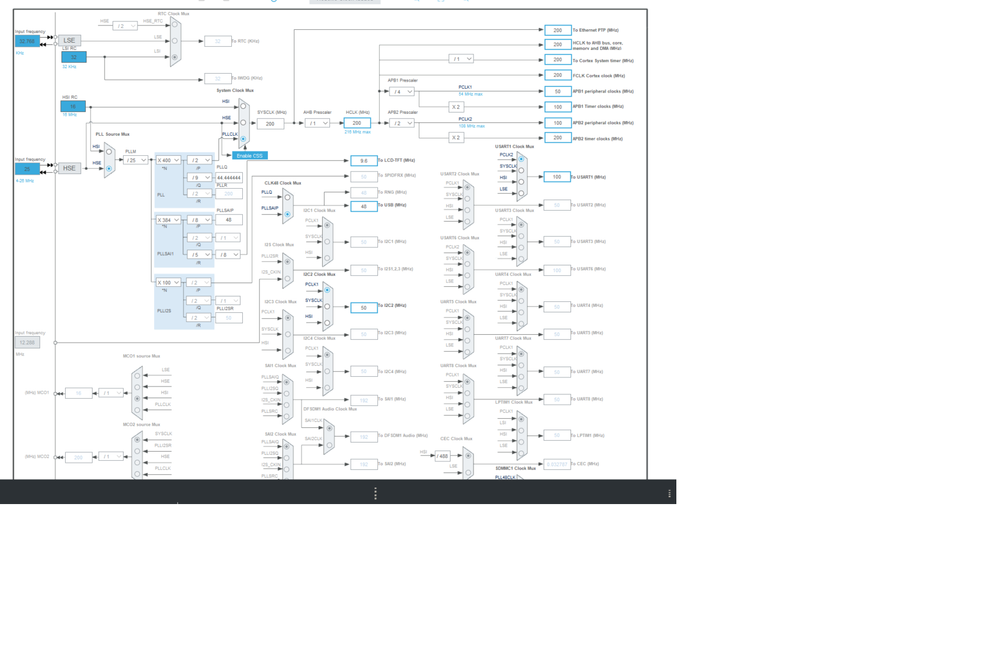

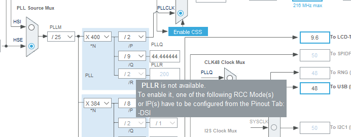

2020-01-24 2:29 PM
2020-02-03 2:02 AM
Hello @svcguy
You have to check if it's being used by a device. If not, it should be grayed out.
Best regards,
Nesrine
2020-02-03 6:34 AM
Correct, it should be greyed out on this device as it doesn’t have DSI, but the clock config code that it generates still fails an assert without a way for the user to change it every time the code is regenerated.
