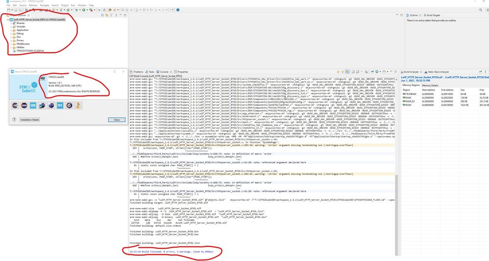

STM32H735G-DK projects and APPLICATIONS ERRORS STMCubeIDE 16.1 LwIP_HTTP_Server_Socket_RTOS - ERRORS ------------ Assertion "REENT malloc succeeded" failed : file "/build/gnu-tools-for-stm32_9-2020-q2-update.20201001-1621/src/newlib/libc/stdlib/rand.c",

i do not made any modification in code.Is a deliverable from ST.

What is your workspace path and same about IDE installation repository ? Any special character usage or long path ?
Which OS are you relying on ? (Win10 myself)
