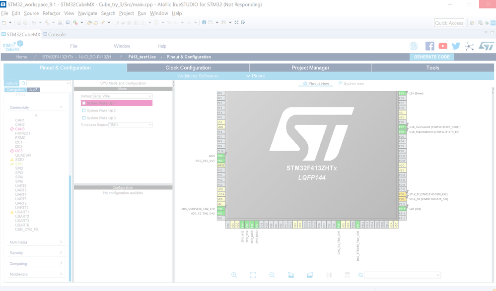

Just upgraded to STCubeMX v5 which appeared to successfully open a project I just started. After agreeing to the annoying "Project has been changed, do you want to save" pop-up, Atollic became non-responsive. Is this a known bug? You have coded a race condition between the timer pop-up and the main GUI thread...

PPS: Just repeated this problem. I was working in SPI configuration when annoying question popped up, I clicked "Save", and Atollic IDE went non-responsive. There's a race condition bug between the pop-up and editing...

@WBOUG - Here's the info:
Atollic TrueSTUDIO® for STM32, Built on Eclipse Neon.1a. Version: 9.1.0 Build id: 20181011-1241
While editing configuration in CubeMX plug-in, the annoying "Do you want to save" pop-up pops.
If you click "Yes" to the pop-up (again, while editing), the GUI becomes non-responsive.
You have coded a race condition in CubeMX, such that:
iff editing is active in the fore-ground, and the annoying pop-up pops, and the user clicks "Yes",
then the GUI may deadlock.
