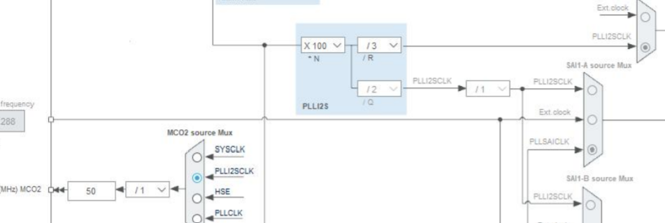

In the clock tool picture below, no less than 3 separate and different clocks are labeled PLLI2SCLK.
So, which one is input to MCO2 source mux?
Also, calculated clock values should be shown on arcs!
ST, Please confirm you understand and reproduced the problems and have filed one or two bug reports...
IOC attached.
PS: CC @Amel NASRI (ST Employee), @Camilo LEMOS (ST Employee)
2020-04-15 8:05 PM
What STM32 is this?
What does the RCC chapter in respective RM say about the MCO mapping?

Hello @Dave Nadler
This will be internally checked
Khouloud
2020-04-30 2:45 AM
Issue fixed, the fix will be available for the next release.

2020-04-30 7:41 AM
@Khouloud ZEMMELI - Which bugs are fixed?
Did you also file a bug report as follows, and is this finally fixed:
Calculated clock values should be shown on arcs!
Thanks,
Best Regards, Dave
@Camilo LEMOS @Amel NASRI
