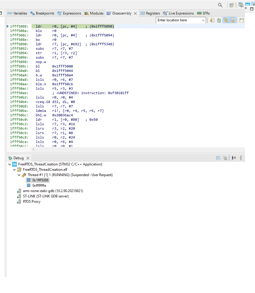

i am stuck with a question i have on debug side. I started a clean MCU project for the EVAL board above - nothing inside. After compiling with no error and trying to enter debub mode picture1 appears shortly (keeps open) and the debug cursor jumps to HAL_Init() as i expect. And program working fine. But what does this break address in the beginning mean? How can i solve this issue? Picture 2 discribes the short visible view in Disassembly

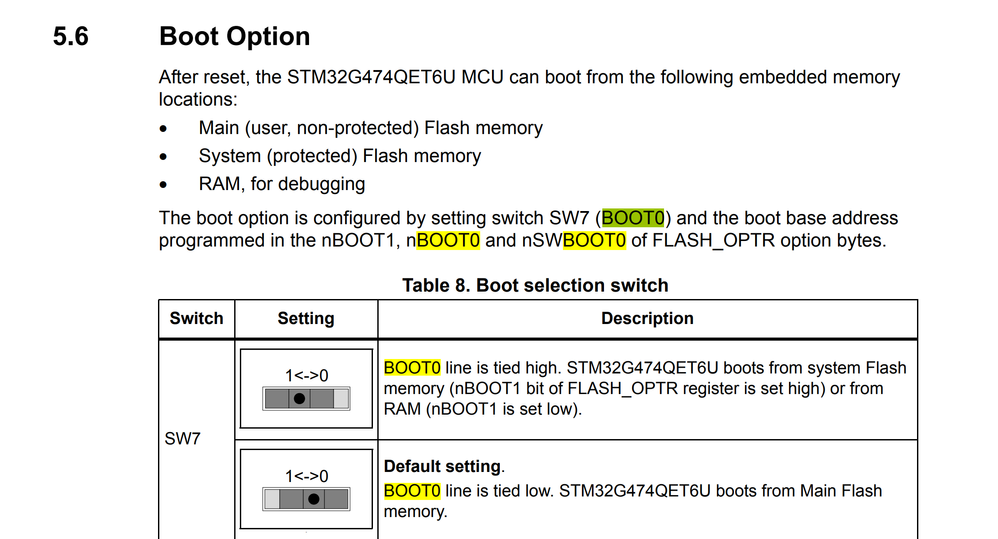

Would check if BOOT0 is switched or jumpered to HIGH, or equivalent Option Byte Settings.
The ROM firmware may also cause this if the device boots with blank flash memory, in which case you'll need to power-cycle, rather than reset, the board for it to run code from flash.
2022-07-06 11:59 AM
Hello @Community member ,
thank you for the hint. I found this discription below. It was initial in default state - i changed it to state 1. Still this error occurs. Any idea?
2022-07-06 1:16 PM
Well setting it HIGH assures it will enter the ROM, in the Default settings it can enter the ROM if the FLASH has no usable vector table at 0x08000000. For normal operation you want the default setting.
Make sure your code starts at the base of FLASH, not deeper into it.
You have to cycle power to get it out of the current state, so if it flags as having no content a reset is not sufficient to recover.

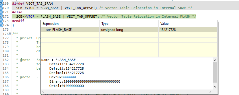

Watch also what memory is mapped at Zero, and what the SCB->VTOR points too.

How do i check if my code starts at base FLASH? Sorry for this dumb questions. You dont need to answer if i am to nooby.

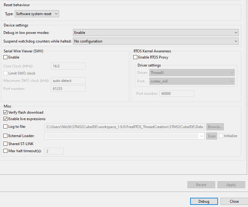

Ok i could solve this error by changing the Resetbehavior from "ConnectunderReset" to below. Any idea? Sorry for this spamming but this goes really out of my horizont
