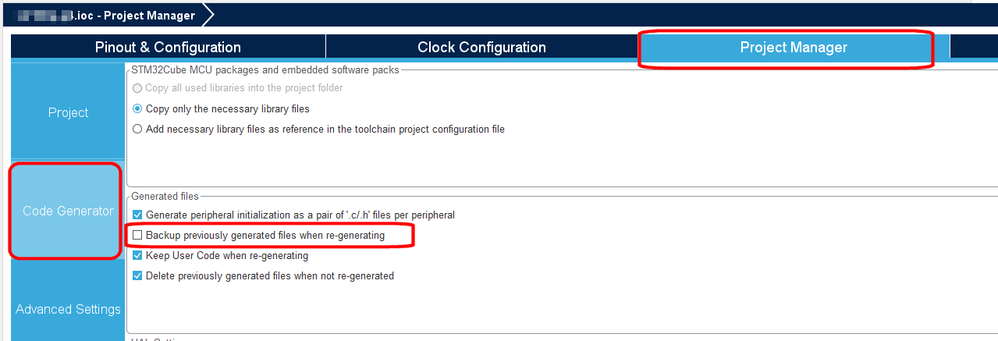

2025-07-24 3:47 AM
@smassardi wrote:Is there any way to prevent this restoring?
No. That is the defined behaviour - only code within the USER CODE markers is retained.
You will have to manually merge your changes back into the code.
There is an option to have CubeMX backup the files that it re-generates:
