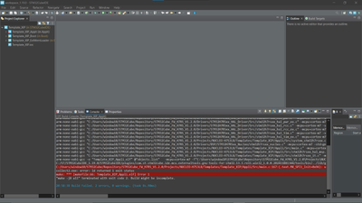

I imported the Template_XIP project into STM32CubeIDE. The project compiled, uploaded to the board successfully, and I was able to debug without any issues. However, after attempting to enable SPI1 using both STM32CubeIDE and STM32CubeMX, and generating code based on those settings, I encountered the following build error in the Template_XIP_Appli project:
/Users/xxxxxx/STM32Cube/Repository/STM32Cube_FW_H7RS_V1.2.0/Projects/NUCLEO-H7S3L8/Templates/Template_XIP/Appli/Src/main.c:201:(.text.MX_SPI1_Init+0x96): undefined reference to `HAL_SPI_Init'
/Users/xxxxxx/STM32Cube/Repository/STM32Cube_FW_H7RS_V1.2.0/Projects/NUCLEO-H7S3L8/Templates/Template_XIP/Appli/Src/stm32h7rsxx_it.c:253:(.text.SPI1_IRQHandler+0x6): undefined reference to `HAL_SPI_IRQHandler'
make: *** [makefile:66: Template_XIP_Appli.elf] Error 1

I recently got access to a Dell laptop running Windows 10 and set up my STM32 development environment. I installed STM32CubeIDE, STM32CubeMX, and STM32CubeProgrammer, then imported the Template_XIP project for the NUCLEO-H7S3L8 board. Everything worked fine at first — the project compiled, uploaded to the board, and ran without any issues.
The problem started when I tried to enable SPI1 using STM32CubeMX. I ran the tool as administrator, made the necessary changes, regenerated the code, and attempted to build the project. Unfortunately, I keep running into the same error every time, as mentioned in my previous blog post. I’ve double-checked everything multiple times, but the issue persists.
main.c:167:(.text.MX_SPI1_Init+0x96): undefined reference to `HAL_SPI_Init'
collect2.exe: error: ld returned 1 exit status
"make -j8 all" terminated with exit code 2. Build might be incomplete.

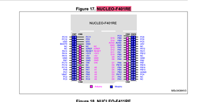

On top of that, the documentation for the NUCLEO-H7S3L8 still doesn’t include a proper pinmap. Unlike other boards like the NUCLEO-F401RE, there’s no clear, visual reference (see picture)
