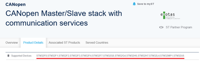

In fact there are two offers for emotas CANOpen:
1- This link:
This offer is for commercial usage and you need to contact emotas over their website: https://www.emotas.de/en/contact

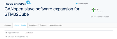

2 This link: which corresponds to I-CUBE-CANOPEN package.

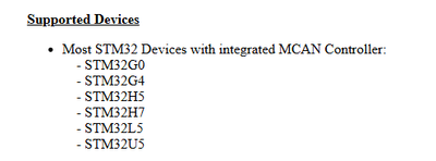

This package is only for evaluation and (for the moment) supports only these MCUs:
From the release notes: Middlewares\Third_Party\emotas_CANopen\emotas\Release_Notes.html
We only put the supported devices STM32G4 in our webpage because it was the only platform validated from our side.
So indeed I-CUBE-CANOPEN does not support STM32F7 family. You need to contact Emotas for that device (the first offer).
1- This link:
