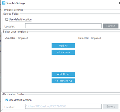

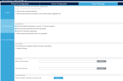

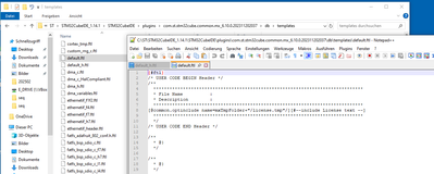

If you want to modify the template please have a look
at
There are the templates.
The settings are in
After "Settings" you can choose here your template.
