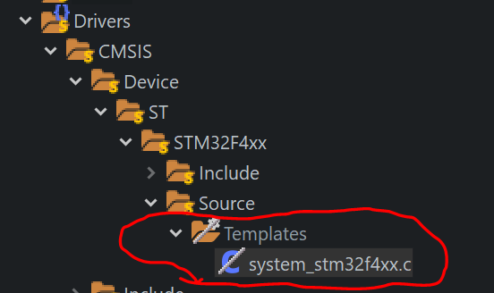

After upgrading the IDE to version 1.5.1 within the eclipse IDE, the CubeMX built in tool auto generates this file.
This conflicts with the one in src (same function is defined in both places). I had to temporarily exclude the folder from build for it to compile properly. My collogues who also have the same version of the software do not have this issue.

Hello @Ahmed
Thanks for your feedback,
Could you please check with the latest CubeMX and IDE versions (6.2.0 and 1.6.0) ?
If problem still occurs, please share your ioc file to check it.
Thanks, Khouloud
2021-03-25 3:09 AM
I cannot share the .ico against the company rules. I'll try to recreate the problem using a fresh .ico file.
I have tried latest CubeMX and IDE versions (6.2.0 and 1.6.0) problem does not go away.
