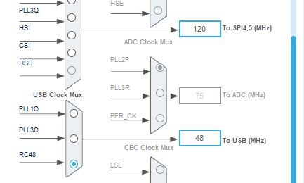

2022-03-21 8:24 AM
The clock "to ADC (MHz)" is grey in clock configuration. Don't see prescaler field in configuration. Plus it remove PLL **** configuration in main.c.

I just started a project from scratch with STM32H750VBTx, I haven't been able to activate ADC clock yet. Pretty easy to reproduce...

2022-03-24 3:09 AM
Hi @GerHebert ,
You're right, the issue is reproduced and confirmed.
Actually, a regression was detected with the latest STM32CubeMX 6.5.0 version: Clock Prescaler parameter removal from the GUI and the non-activation of ADC Clock Mux although the ADC is configured.
As mentioned by @Amel NASRI , this misbehavior was already reported internally to be fixed as soon as possible.
I'll keep you posted with the updates.
Sorry for any inconvenience that this may cause.
Khouloud.

36 days have passed and this is still broken, wow. I just spent two days trying to figure out why my project is suddenly broken.
For anyone wondering: downgrade to version 1.7.0. You have to change you ioc file version though:
