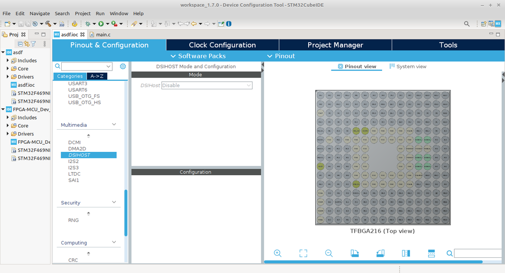

Quite possibly a dumb question as I am just starting to use STM32CubeIDE, but using Pinout & Configuration editor for STM32F469NIH device, I immediately (without any more allocations) see DSIHOST as greyed out. No helpful hints of any kind are displayed. This is a critical interface for me. Why is it greyed out???

Nevermind, hovering over the "Disable" greyed out line in drop-down box is how I get the explanation for the option being grayed out (sorry, I never saw hints from greyed out items in other software, still learning this IDE)...
