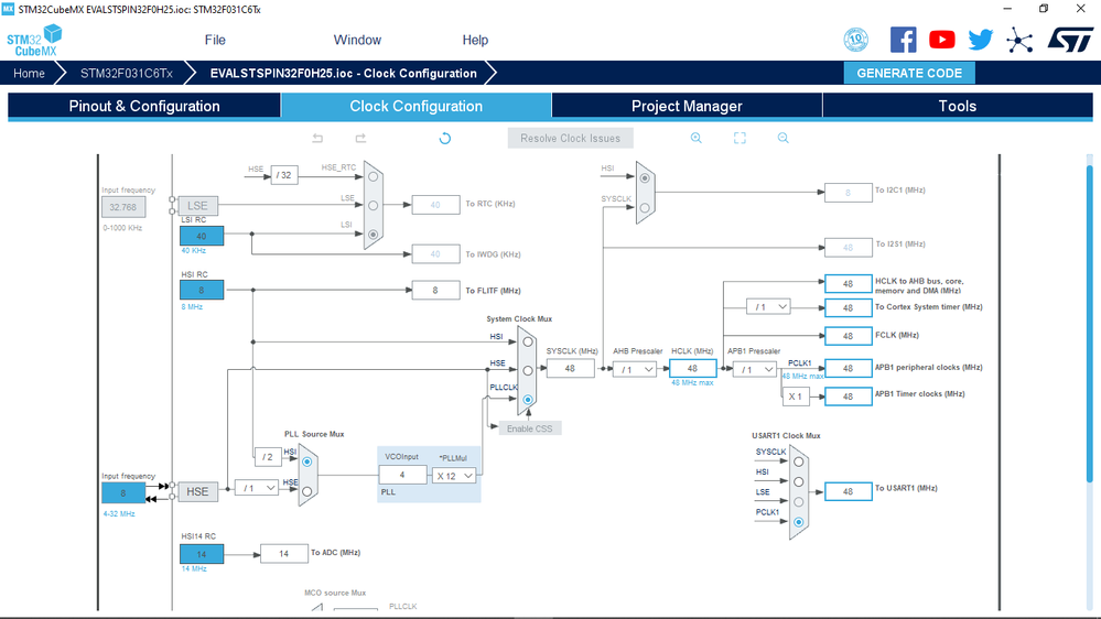

Presently my systick timer is set to 1ms. Does anyone know how to configure that to be set to 1us? Also can It be set such that it increments by 0.1us?
This is the present clock configuration
Here is the present system clock configuration code that I have
