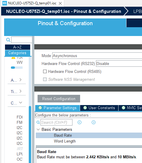

Nowadays, UART speed can go higher than 5Mbps, in your case U5 Nucleo (assuming NUCLEO-U575ZI-Q) can reach 10Mbps. If data are sent as raw binary data, you may need to write your own protocol.

2022-08-02 7:10 AM
