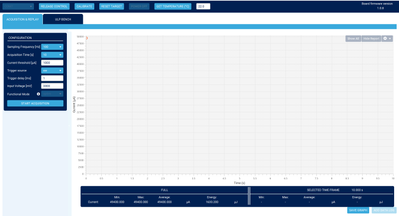

Hello ST Community,
I'm using STM32CubeMonitor-Power (latest version) with an X-NUCLEO-LPM01A board (firmware v1.0.8), and I'm facing an issue in static current measurement mode.
Problem Description:
  • In standalone mode, the static current displays some current2, which is expected.
  • However, when I take control via software and press Start Acquisition”, the session runs for only ~0.1 seconds and then stops automatically, without any error message.
Additional Observation:
  • In dynamic measurement mode, the current acquisition works as expected.
  • This suggests that the board and measurement path are functioning correctly, and the issue is specific to static mode under software control.
Is there any recommendation to fix this issue?
Thank you for your support.

Uday
Associate II
This is the screenshot that I took during the static measurement, attached for reference to the problem that I stated.
