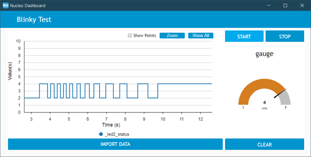

Made a simple "blinky monitor", and I'm impressed with the tool. I've previously used UART -> Serial plotter to plot my graphs. I will definitely use this tool in future projects.
Some things I'm missing (based on a few hours of experimentation):
I'm looking forward to future updates. And @stephane.legargeant , kudus to the development team: this is indeed a useful tool.

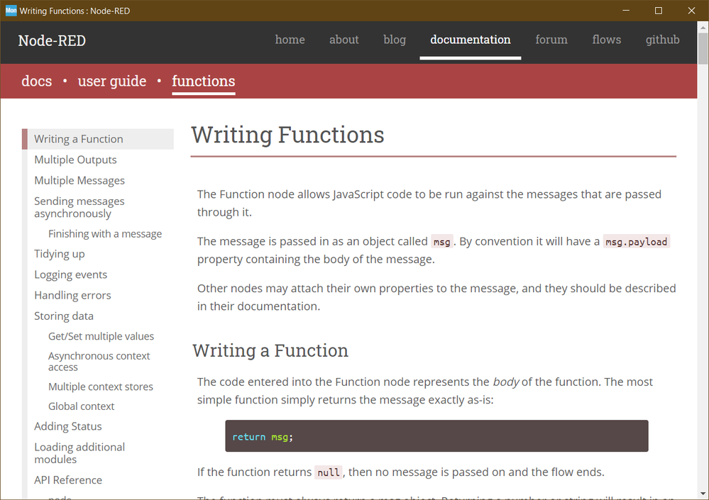

I may have come across a bug: I launched the documentation window by clicking on the "function" node => information => details => "online documentation" link. Whenever that's open, I am unable to launch the dashboard by clicking the "dashboard button.
2020-03-09 10:23 AM
Hello AShri.1
You are right, when the online help is open, the dashboard should be displayed, but it is not.
I can suggest 2 workaround :
Best regards
Stephane

Thanks a lot for the feedback, it is very interesting for us.
Some answers to your points :
Best regards
Stephane
