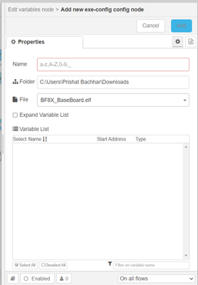

Currently I am facing a issue where my CUBE monitor is not able to parse the ELF files. It gets stuck at 10% completion while loading it. I have attached my workflow below:
The Error is as follows:
It will be very helpful if anyone can provide any insights as to what might be the problem.
Thanks,
Prishat

2025-09-04 1:10 AM
None of your screenshots is related to an ELF file.
