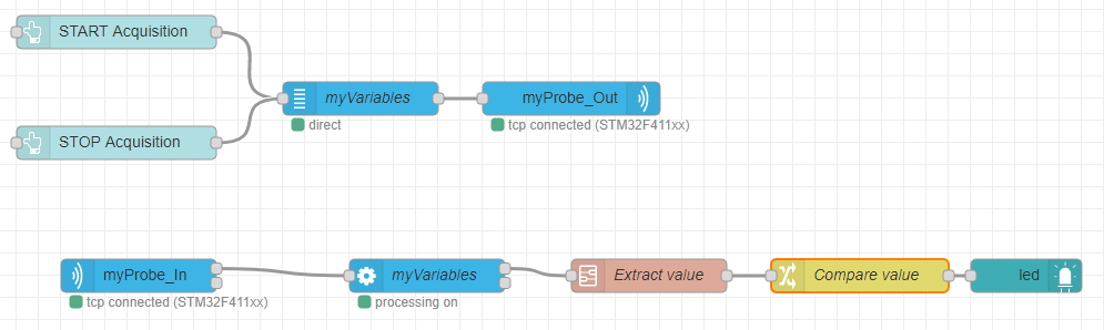

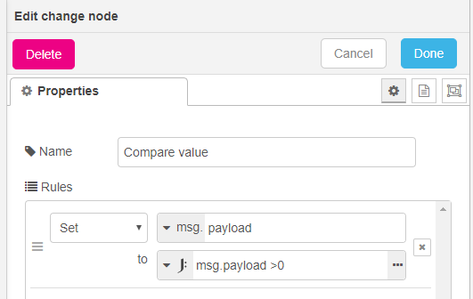

Hello
To switch the led color, you must send a msg with a specific payload. By default, the ui_led will turn to green when boolean value true is received, and to red when false is received.
The subflow "Single Value" in the palette will help you to parse the data : it will extract the value you want to monitor.
Here is an example :
In this example, the Led will monitor the value of variable "g_counterShort".
The "change" node will send "true" is value is above 0, else it will send "false". You can customize the condition for your need.
Best regards
Stephane

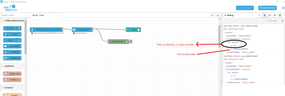

2020-07-24 11:10 AM
Thanks @Thierry
I am able to install the mentioned led node using "Manage Pallet" option although it was not there earlier and after following the link you have to given in the above post, I am able to get it.
But, I am still not able to turn the Led On-Off on the dashboard.
Reason for this is, I think I have to pare the data, but how I can do that, the chart provided by ST can do this by default.
Can you please suggest how to do this?
And what I need to learn to understand this concept.

Hello
Best regards
Stephane
