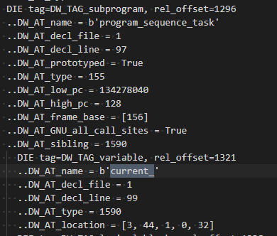

Code:
Dwarf parsing useing pyelftools (modified example of https://github.com/eliben/pyelftools/blob/master/examples/dwarf_die_tree.py) to output also all DIE properties
"current_" is on location:
DW_AT_location = [3, 44, 1, 0, 32]
DW_OP_addr = 0x03, next bytes are in little endian
0x2000012C
