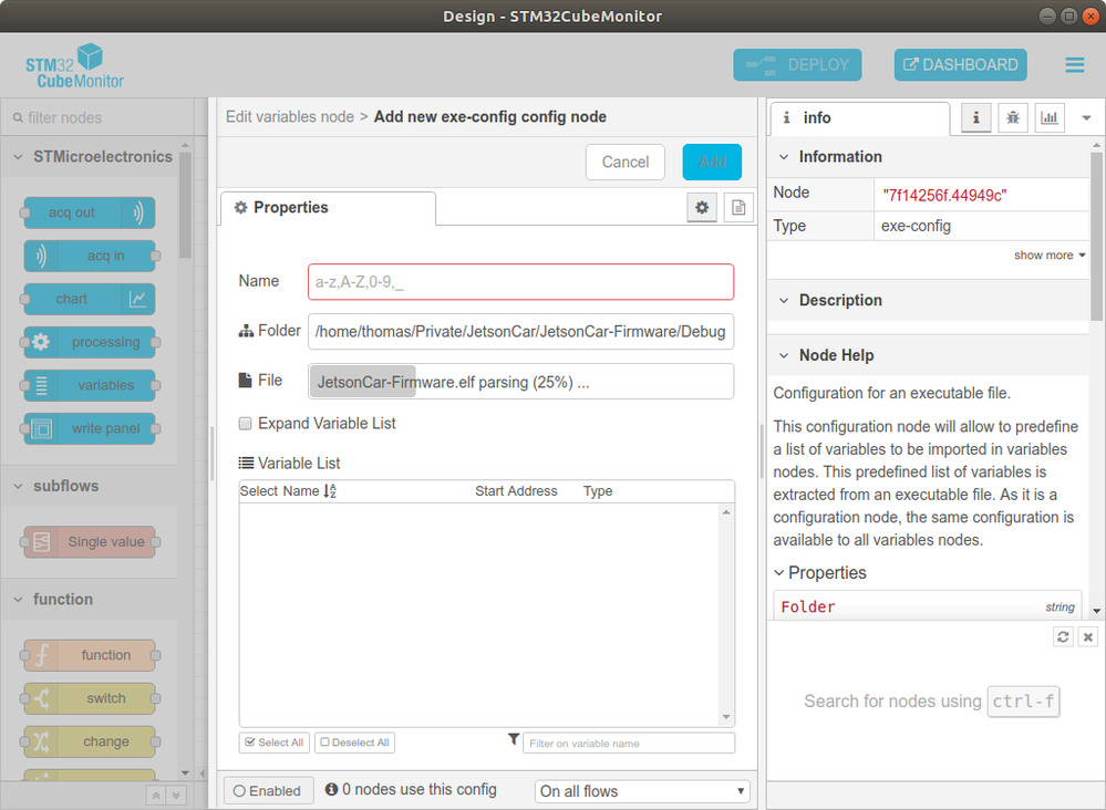

I have just installed STM32CubeMonitor as an alternative to STM32Studio since I am no longer using Windows. I have been a happy user of STM32Studio but have been frustrated with the lack of Linux support, so I was excited to see that STM32CubeMonitor supported Linux.
Unfortunately my first experience with it did not meet my expectations.

I don't see the picture with the ELF parser stuck. Nevertheless, are you using version V1.1.0 ? We have done some fix, it may solve the issue.

2020-09-22 6:04 PM
Yes, I am using V1.1.0. I have tried to attach the image again.

It seems there is something blocking the elf parser in your elf. What is the size of the file ?
Is it possible to share the elf with me ? (you can send me a private message)

2020-10-07 7:15 AM
It seems that problem is only present in version 1.1.0 of STM32CubeMonitor.
By installing version 1.0.0 I am able to load the ELF file successfully.
PS. I am using C++ in my embedded project. Maybe this plays a role when loading?
2020-10-07 8:43 AM
Hello Thomas.
The support of some c++ symbols has been added in V1.1.0, so it may generate an issue during the parser. In V1.0.0, these symbols were skipped. .
Stephane
2020-10-12 2:27 AM
Hello
We have identified an issue : The tool fails to parse the c++ classes which have references to themselves.
As c++ classes is a new feature of V1.1.0, it is possible to use the version 1.0.0 as a workaround if you face this issue.
