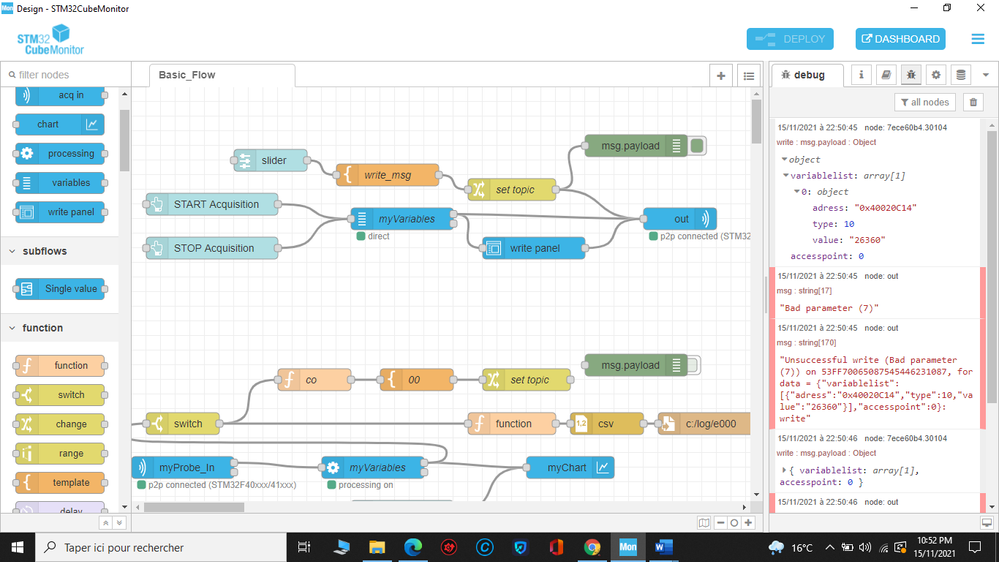

2021-11-15 1:54 PM
I do the same work as the link, this is my basic flow .
thank you
2021-11-16 3:20 AM
Do you mean that it is still not working ?
If it is not working, could you share your flow with me ? (at least export the nodes on the top part)
Best regards
Stephane
