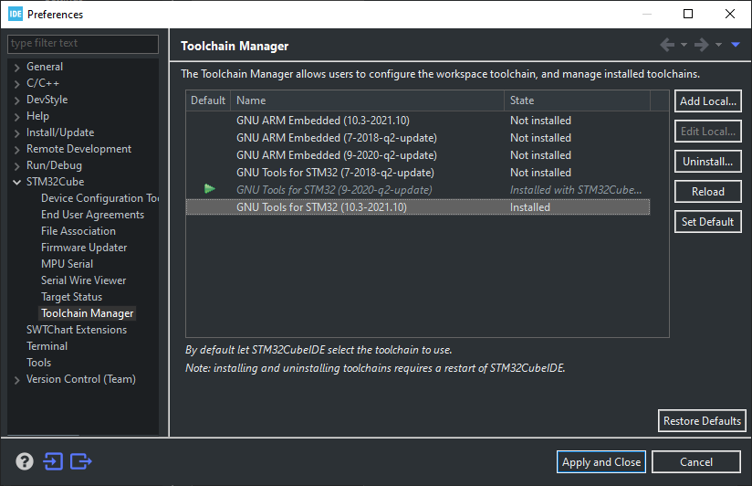

2021-11-30 12:00 AM
Hi Stephan,
Thanks, but I have understood this already. My question is how should I do it? There is no new toolchain in the Toolchain Manager.
Regards,
Dmitry
2021-11-30 12:04 AM
That's strange. I did no extra steps. The toolchain was right there.
