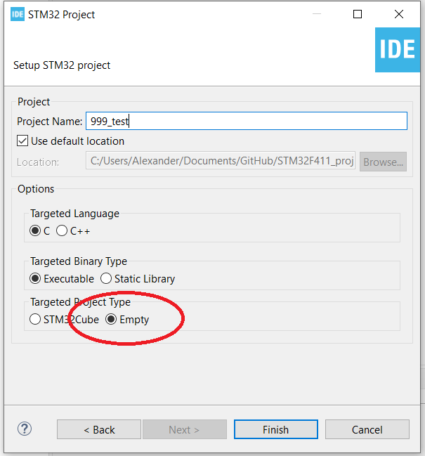

I generated a blank STM32CubeIDE project, see attached figure. When using the pin configuration tool and generating a HAL based project, the #if ... block is not generated, either.

> did you end up with HAL/LL and a setup of your MCU?
Yes, you're right. I'm using "Empty" rarely, but tried it now and got the same code sequences as you did. Note that __SOFTFP__ will be defined when you invoke gcc with  -mfloat-abi=soft and __ARM_FP is defined when specifying -mfloat-abi=hard. So, the generated #if block shall remind you to add a line for FPU initialization because no SystemInit() code is generated in "Empty" projects.
Did you try FPU instructions? When the FPU was not initializied, you will get a fault at runtime (no coprocessor).
