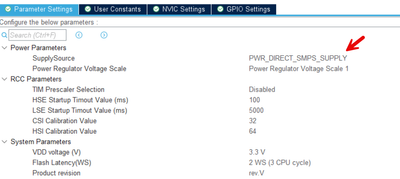

i configure power as PWR_DIRECT_SMPS_SUPPLY,

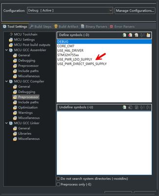

but after generating project, both PWR_USE_LDO_SUPPLY and PWR_DIRECT_SMPS_SUPPLY are defined. This will cause program exception sometime, i have to remove USE_PWR_LDO_SUPPLY. I took several days to locate this issue!

I use STM32H755ZIT6, if generating from ST board NUCLEO-H755ZI-Q in CUBEMX, it has no this preprosssor. If generating from chip level, even has no any IO setting, the two predefined marco are there. You can try this, it's really tricky! I want to know where it is from.

2024-12-29 8:05 PM
i was using code comparison, and no any clue found. Finally, i found the difference in complier setup inside of IDE.
The consequence is board will never boot up, and ST-LINK can not find target. You have to set to boot from system memory to recover the board. This is typical consequence of wrong power scheme. Some guys may ran into this issue in this community, but no one tell the clear answer.

The above are not problems, this is routing step for MCU lockout. This is not stress of my post. I am asking why Both USE_PWR_LDO_SUPPLY and USE_PWR_DIRECT_SMPS_SUPPLY are defined during code generation. This will cause MCU lockout after power cycle.

This later (Both USE_PWR_LDO_SUPPLY and USE_PWR_DIRECT_SMPS_SUPPLY are defined as preprocessors) is the confirmed issue that I tracked internally with the ID 199456.
I checked that there is no such issue when generating EWARM project.
-Amel
