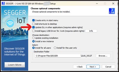

@Ckerl.2 Download and run latest J-Link installer from Segger https://www.segger.com/downloads/jlink/
(this is a bit confusing: the J-Link installer installs a large set of various programs and utilities. Some of them are interesting and useful, others less so).

Tried this, same behavior when debugging CM4 core, says device not supported and could not verify device.
Then goes to immediate hard fault.
Tried on windows, windows has a JLINKDLLupdater executable.
Wondering how I would get to work with linux, can I just copy over st files with latest segger.
