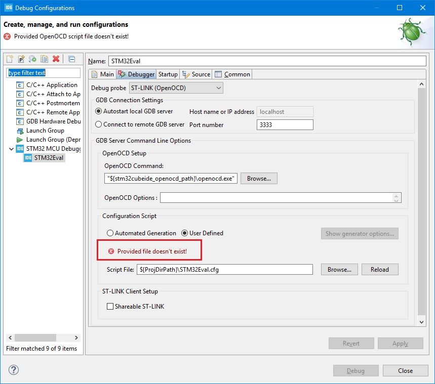

When I specify a user debug script in STM32CubeIDE debug configuration window I get the error "Provided file doesn't exist" even though it's there. Even if I specify the same text as the "Automated Generation" option I get this error.
Is there a workaround ?

2019-08-15 7:21 AM
Mattias,
When I browse to a configuration file, even one generated by STM32CubeIDE, then close and re-open the debug configuration window I see get an error - see attached. There's also an exception popup and the corresponding entry in the erorr log is listed below. Hope that helps.
Thanks
Dave
