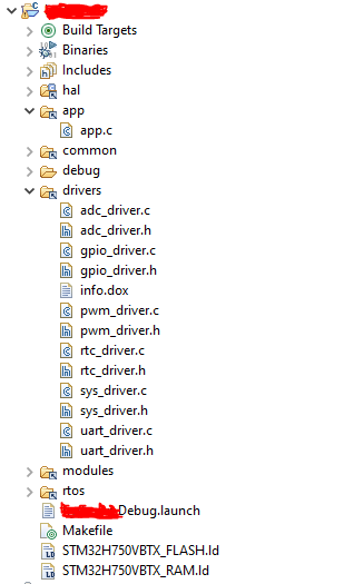

2020-04-07 6:16 AM
Hello @Pavel Širů�?ek
Could you please provide us the structure (in text form is fine, for example C:/MyProjects/MyProject) for the project and for the additional files creates that experiences the error when CTRL + clicking them? Also a screenshot of the Project Explorer view might be helpful.

2020-04-17 7:43 AM
sure. Project location is:
D:/fw/projects/projectName/.project
And sources location is:
D:/fw/sources/common/example1.h
D:/fw/sources/common/example1.c
D:/fw/sources/drivers/adc_driver.h
D:/fw/sources/drivers/adc_driver.c
Workspace location is:
D:/fw/workspaces/projectName/
Project setting:

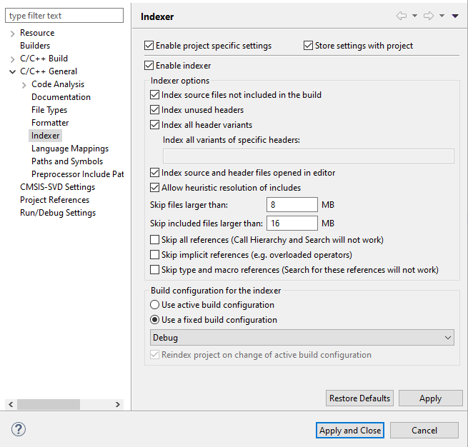

2020-04-29 2:13 AM
Hello.
I finally solved this problem.
Here's how for everyone with the same issue:
1) Go to Project->Properties.
2) Search for indexer.
3) Set to this setting:
4) Rebuild index.
I don´t know, what setting is responsible for fixing this issue, but everything is working now, and this is what is important for me.
Thank you all for help.
Best Regards,
Pavel
