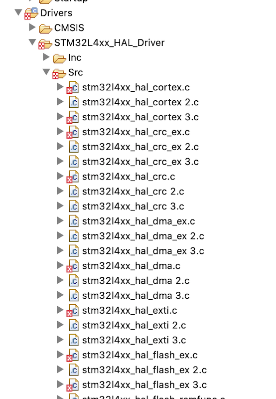

I am using STM32CubeIDE on MacOS. I am finding that very often, at least every other build, CubeIDE duplicates a bunch of drivers in the HAL driver folder. When that happens the compiler throws a bunch of "multiple definition" errors. To fix that I go into the HAL driver folder and delete all the duplicated. Then all is well until it happens again on the next build or maybe the build after that.
Then, once in a while, there is a long period of time when it doesn't do it. Crazy.
Here is an screenshot of part of my CubeProgrammer GUI showing the dups:
I have also attached a zip of my project.
This is my biggest time waster right now and I'd sure like to know how to stop this from happening. Thanks for your help!

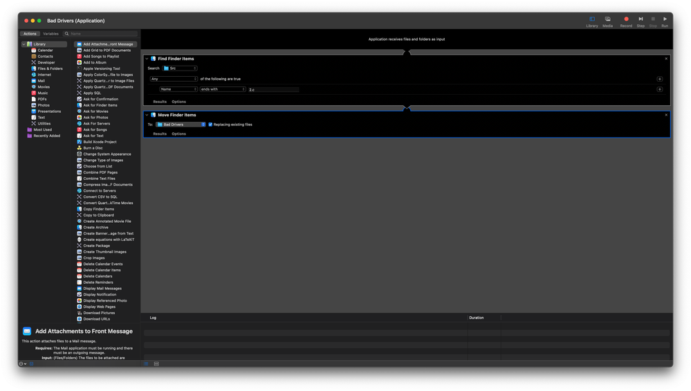

So I don't know if you are still having this issue, but I have been having it so I created an automaton application to easily remove the files for me.
This way when the driver nonsense happened I can just press "cmd+space" on my keyboard type in "Bad Drivers" and it will automatically move the duplicated drivers to a folder in my documents (just so I can verify that only the correct ones have been moved. You can alternatively move them directly to the bin.
Hope this helps!
