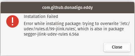

There is a big issue I'm facing. I just installed STM32CubeIDE 1.2.0 but then I get an error when trying to install JLink_Linux_V662_x86_64.deb
I absolutely need those tools because I also do development for other boards with Segger JLink probes.
What is going on? My system is Linux Pop!_OS 18.04 LTS x86_64

2020-01-31 1:56 AM
Hello m4l490n,
To install JLink_Linux_V662_x86_64.deb, you must first remove segger-jlink-udev-rules with the following command:
sudo dpkg -r --force-depends segger-jlink-udev-rules
This should not be an issue to run CubeIDE as segger-jlink-udev-rules only delivers /etc/udev/rules.d/99-jlink.rules which is also provided by JLink_Linux_V662.
Best regards.
2020-01-31 4:59 PM
I can successfully install JLink_Linux_V662_x86_64.deb now with the suggested command but then STM32CubeIDE disappears. To install it again I have to uninstall JLink_Linux_V662_x86_64.deb and then I end up as in the beginning.
