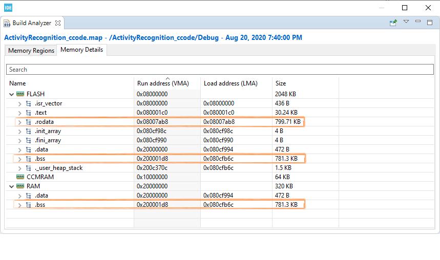

I have created a STM32 application using STM32CUBDEIDE. I'm using STM32F469IH6 for this project.
I have declared few uninitialized variables in one file. I know this affects ".bss" section but it is required in my code. This causes an error saying "section `.bss' will not fit in region `RAM'" in my application". I have few question regarding this?
float C[40000] __attribute__((section ("RO")));3.Same object file(predict.o) was stored in both '.rodata' and '.bss' sections? I have attached .map file for more details.
Please find the map from below location:
https://drive.google.com/file/d/1AOiWwmsoodgzdnbz0I5Hp1NzAgetNKRA/view?usp=sharing
Thanks in advance,
Hari

Is that really the default linker script? Definitely doesn't look viable, did you edit this?
This one would work better
STM32Cube_FW_F4_V1.25.0\Projects\STM32469I_EVAL\Templates\SW4STM32\STM32469I_EVAL\STM32F469NIHx_FLASH.ld
Not sure how 700KB of data would fit in 320KB of RAM which ever way you turn it.
2020-08-20 10:02 AM
Your MCU has 320+64 KB of RAM, but you are trying to put almost 781,3 KB in it. That's just not possible! :)
2020-08-20 12:57 PM
If you qualify the array as const, gcc will put it into the FLASH instead of RAM. You want to provide an initialize for it and it's of course read-only.
