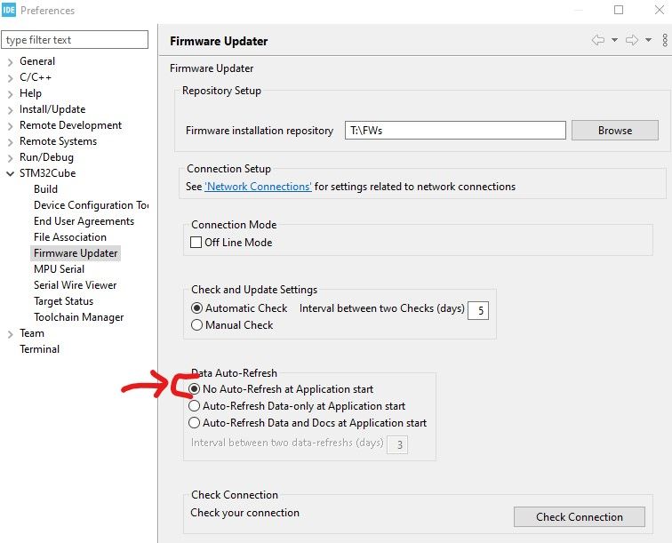

Which STM32CubeIDE release are you relying on ?
If old one please update ... (current is 1.6.0)
If recent release maybe local network issue. In order to workaround waiting for alive connection have a try to:
Would advice to come back to default setting as soon as possible then. If not you are going to possibly miss some important update at a time.
