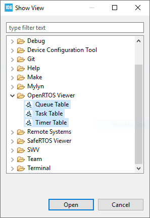

If you use FrreeRTOS then you can try the state-viewer plugin from this web page:
https://www.highintegritysystems.com/tools/stateviewer/
It provides the Task, Queue and Timer views.
