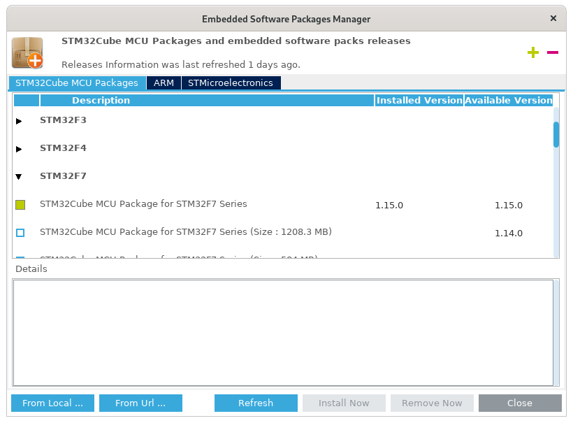

I generated a project with the boad wizard. It actually downloaded a big MCU package. I wonder where this is downloaded and if I can find the corresponding HAL and Low-layer drivers documentation.
I am on Linux.
Thanks
2020-02-17 11:10 AM
Once download is completed you'll find material repository Thanks Windows > Preferences > STM32Cube > Firmware Updater ... Firmware installation repository field.
