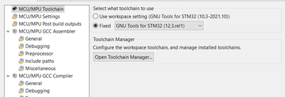

I am completely new to STM32CubeIDE and I am attempting to build a project, using a different toolchain than what is the default.
When I attempt to build the project using the default toolchain "GNU Tools for STM32 (12.3.rel1)", the project builds just fine. However due to a problem with that toolchain on the project, I am required to use a different toolchain.
When installing and using a different toolchain (I have tried multiple and have gotten the same following issue), I get the following error:

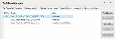

The default toolchain that I used that *is* capable of completing a build is GNU Tools for STM32 (12.3.rel1)
And the two that I have tried that are *not* capable of completing a build are as follows:
I apologize for my lack of understanding, but what do you mean by "similar layout (subdirectories)"? I am not sure where to look to answer that question.

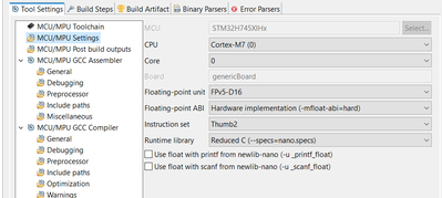

When selecting the default and functioning toolchain, 12.3.rel1, in the MCU/MPU Settings, all of the available dropdowns are filled with selections:

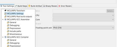

However, when selecting a different Toolchain, say 10.3-2021.10, all of those dropdowns are empty, and it also is missing dropdowns:
