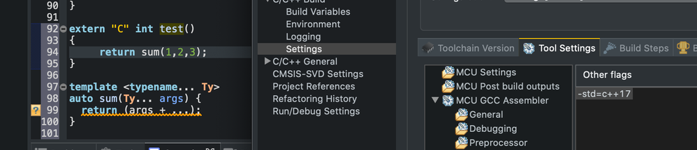

I am using IDE 1.5.0 with the -std=gnu++17 flag set
When trying to use fold expression, the compiler throws an error.

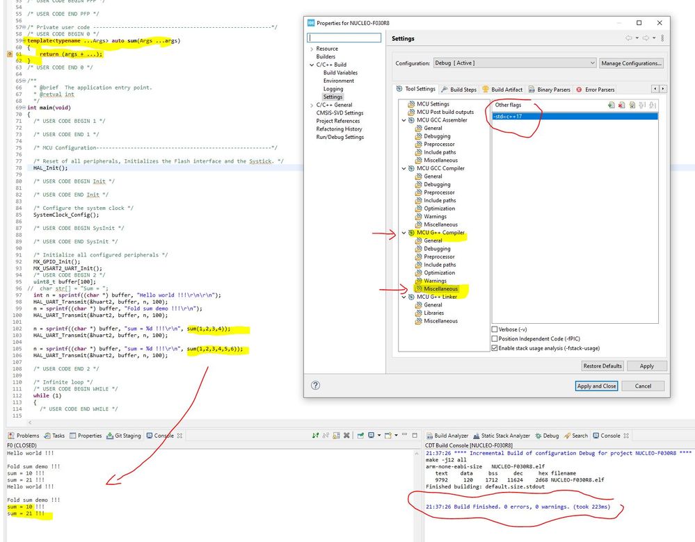

I'm not keen on new language features, but a simple test worked when test() called from main():
template <typename... Ty>
auto sum(Ty... args) {
return (args + ...);
extern "C" int test()
return sum(1,2,3);
}This is more a g++ question rather than STM.

STM32CubeIDE 1.5.0 (1.4.2 is fine too) no issue to me if C++17 usage. According to me proper g++ switch is "-std=c++17" not "-std=gnu++17"

It doesn't work for me and on -std = c ++ 17
2020-11-19 12:55 PM
Correction: works, but IDE emphasizes fold expression. Apparently we should expect further fixes.
