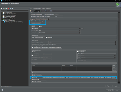

Hello @ubaldot
In the Debug Configuration>Debugger you can click on "Show Command Line" to see the debug command.
Also you can enable the log as shown in the screenshot bellow.

Hello @ubaldot
