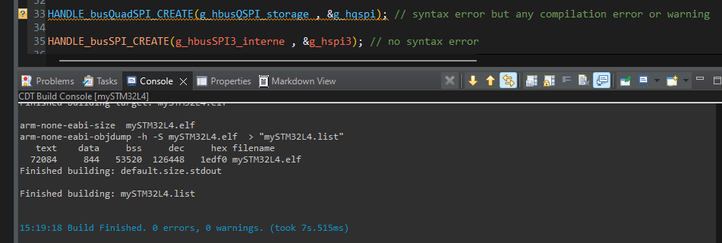

I have a syntax error on one line but no compilation error with stm32cubeide 1.14.1
HANDLE_busQuadSPI_CREATE(g_hbusQSPI_storage , &g_hqspi) ; //syntax error
HANDLE_busSPI_CREATE(g_hbusSPI3_interne , &g_hspi3); // no syntax errorwith
#define HANDLE_busQuadSPI_CREATE(var, s) \
busQuadSPI_handle_t var = { .quadSpiHal = s, .mutex = NULL , .state = QSPI_STATE_Ndef }and
#define HANDLE_busSPI_CREATE(var,s) \
busSPI_handle_t var = { .spiHal = s, .mutex = NULL , .state = SPI_STATE_Ndef }
if I don't use macro : no syntax error
busQuadSPI_handle_t g_hbusQSPI_storage = {.quadSpiHal = &g_hqspi , .mutex = NULL , .state = QSPI_STATE_Ndef } ;
HANDLE_busSPI_CREATE(g_hbusSPI3_interne , &g_hspi3); what can happen?
Thanks in advance

I tried launching the preprocessor with this
I had a lot of not explicit errors (something not configured I would say) but... Eclipse asked me if I wanted to update the "indexes"
I said yes and I no longer have the syntax error :victory_hand:
I still have to understand what these indexes are...
Thank you all for your help

There is no compilation error, just a syntax error in the editor.

2024-01-29 6:13 AM
Can you screenshot what you're calling an error? Hard to understand when there's no output. Can you hover over the "error" to get more info?
I'm sure error checking can be disabled.

2024-01-29 6:28 AM
No errors or warnings during compilation
No messages in "Problems"
but an ugly thing on the code which calls out for nothing
I searched for a long time in the preferences to desable error checking but I couldn't find it.
