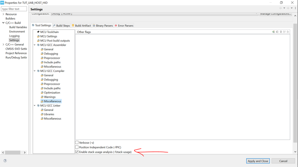

In order to use -fstack-protector in STM32CubeIDE, you can follow these steps:
Once you have enabled -fstack-protector, the required functions, including __stack_chk_guard, will be automatically generated by the compiler. You do not need to override these functions, as they are part of the compiler's implementation. It is a security feature that can prevent buffer overflow.

According to the GCC documentation, stack-usage and stack-protection is not the same thing.
https://gcc.gnu.org/onlinedocs/gcc/Instrumentation-Options.html
stack-usage is indeed useful, but it is not the feature that is requested by the OP.
