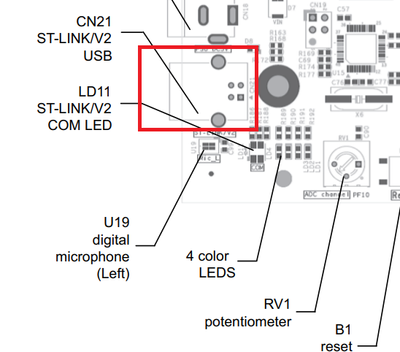

No need to to but an ST-LINK as there is an embedded one on the board and you need to connect USB cable to CN21 connector.

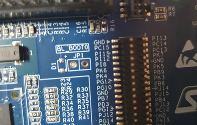

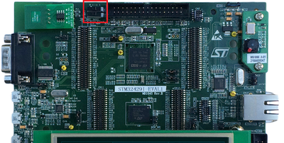

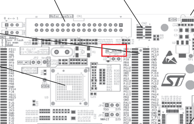

Sorry I meant these two switches. They need to be at position 0 as following:

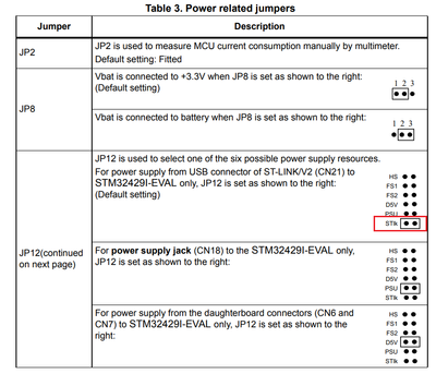

Also How you did configure the power supply? i.e. what about JP12 position?
You need to fit it at that position: "STlk":

How did you connect the board to the PC?
This is the ST-LINK connector you need to connect to.
No need for DFU mode (bootloader over USB) as you are using ST-LINK.
What about Boot switch position? position 0?
2024-06-26 6:34 PM
I did nothing to boot position as following picture:

2024-06-27 1:19 AM
