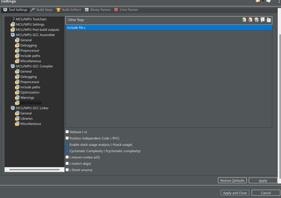

I have an STM32H743 project generated and i'd like to include an external file using the GCC "-include file" command option. I've added it as shown in this screenshot under C/C++ Build > settings > MCU/MPU GCC Compiler > Miscellaneous
The problem is the compiler doesn't seem to find file.c, no matter where I place it within the project directory. I've tried placing inside the same folder as main.c with no success.

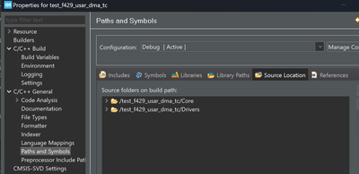

Update: I think i've figured out how to get it to know where the file is, by adding the path under C/C++ General > Paths and Symbols > Source Location. But I still have these make errors:

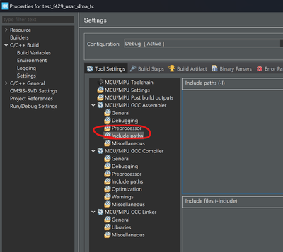

Source files (*.c) shouldn't be included. They are not within the include path if you are using an inc/src folder structure.
Include folders should be listed here for the various compilers. I should have circled the "GCC Compiler" one instead of assembly.
Source folders should be listed here:

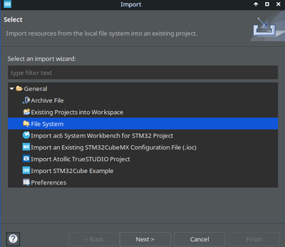

So you want just add a file to a project ?
Then IDE should know this :
open your project (left pane) and right click on the project name : select : import.
then you see:
then use > file system -> and set directory for import, then select .c or .h files and the folder, you want to have them.
Then IDE knows...if using include xx.h , what you want and will compile the c files imported also.
