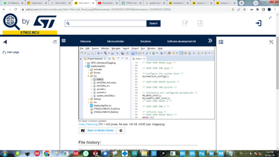

Looking at this screenshot, why do you feel that C++ Builder will not be able to compile this source?
This screen is almost identical to C++ Builder

@techdesk wrote:why do you feel that C++ Builder will not be able to compile this source?
I didn't say that it wouldn't be able to compile it - I said that it wouldn't be able to generate code for a Cortex-M Target.
And that's before you even get to loading the code onto an MCU target, and debugging that code in the Target.
