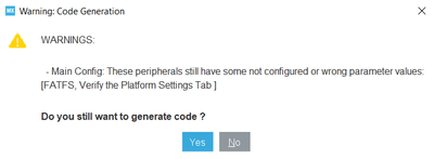

I am looking to write data in csv format to my SD card with an SD shield. So I activate the SDMMC1 port and the FATFS driver for my SDMMC1 port, when I generate I then have 300 errors on my HAL header. Do you have any idea what the problem is, and how to solve it, please? THANKS.
