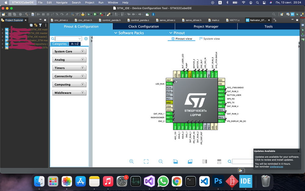

STM32CubeIDE hangs on close, on macbook air mac os Big Sur CPU: Intel core i3. After forced closing, the next time you start STM32CubeIDE, it opens some strange interface that is different from the usual interface (I attach the screen), this problem creates a little inconvenience and I would be very grateful if you could advise ways to fix it, thanks.

I don't really see what's wrong with the screenshot, it looks as expected to me. However, perhaps I am missing something?
There were a lot of improvements in STM32CubeIDE 1.7.0 for example if CubeIDE was hard-killed with the MX editor opened which should be fixed now.
You mention that you tried with version 1.7.0 as well and there's another bug? What window disappear when you hover over them with the mouse cursor? Could you take a screenshot or a short screen recording capturing how it looks when it disappears?

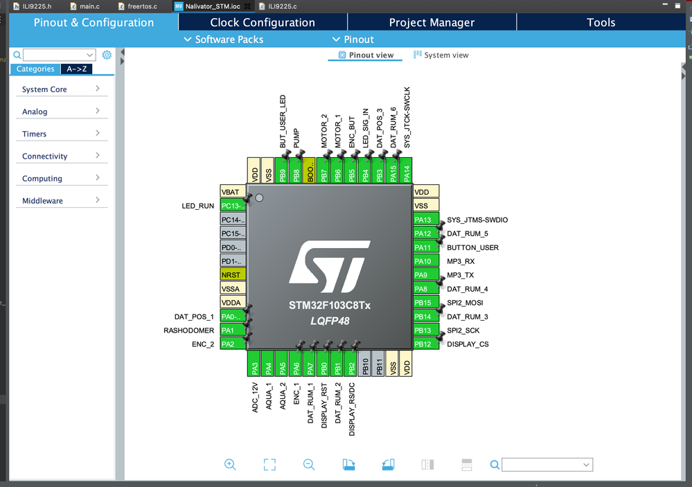

Good day! forgive me for not answering for a long time, I attach a screen of how the interface should be. On account of the disappearing windows (closing on their own), I noticed that this happens only when the MX editor is open (and not always), if you do comit git in the open listing with the code, then the pop-up window does not close on its own, for me now this is not critical, so how will I make a commit just without opening the MX editor.
There is also one very unpleasant bug, when the MX editor is open and you go to the tab with the code, it automatically returns to the MX editor, after the second click on the tab with the listing of the code, it opens the necessary tab, I also attach the video. Thank you for the attention.
