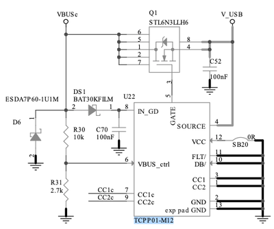

Probably I discovered the problem.
When CAD_Check_HW_SNK is called, none of conditions to change CurrentHWcondition to HW_Attachment is fulfilled. This is happening because CC1 and CC2 in WINBOX1 is not connected to STM32.
See schematic:
The question is then how can I put this working or do I'm missing something else?

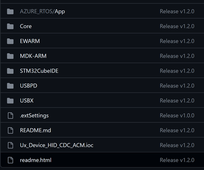

When you follow the you need see structure
i dont see it in your zip file
Opened the project from https://github.com/STMicroelectronics/STM32CubeU5/tree/main/Projects/B-U585I-IOT02A/Applications/USBX/Ux_Device_HID_CDC_ACM and also don't see your structure.
See schematic:
