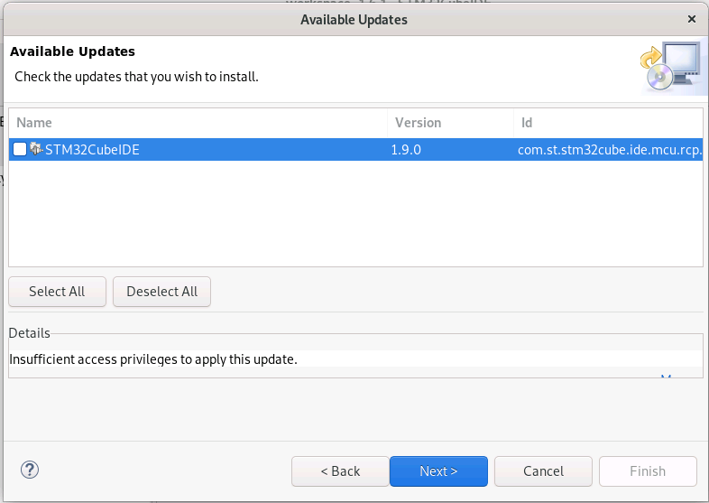

If you launch STM32CubeIDE as a standard user you should get this kind of error:
If you launch STM32CubeIDE as root (sudo), which is totally not advised, then you should be able to update. At least it has worked fine with my 1.6.1 installation few minutes ago...
