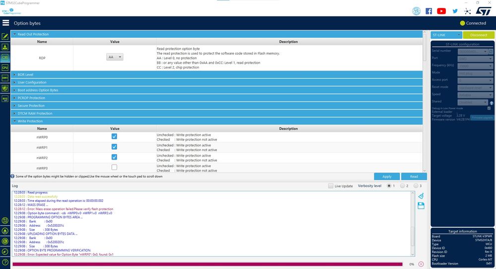

I still can't just clear all the flash. Here's a screen shot of what happens. I've tried checking and unchecking the nWRPx boxes and CubeProgrammer just sets them back to their default setting: nWRP0, 1 and 2 are checked. nWRP3-34 are unchecked and nWRP35-63 are checked. .
At one point after fumbling around reinstalling software and trying to clear at least some of the flash with CubeProgrammer, I was able to build a new Blinky program, load it with CubeProgrammer and it ran. I wish I could tell you what I did to get this little bit to work but it was kind a random process. Unfortunately, when I try to load the program that I've been working on, I get the errors at the bottom of these messages. This program is much larger than the Blinky program I mentioned above, it's something like 360 kBytes if that matters.

2024-02-25 6:01 PM - edited 2024-02-26 9:30 AM
I was finally able to clear all the flash on my MCU. I had to connect BOOT0 to ground (not 3.3VDC). This seems incorrect but it did work. I've started and stopped the program, the IDE, the STLink-V3PWR several times and shut everything down and rebooted the computer a couple of times and I can still download, run and debug my main program. So that's good. Hopefully, it will last for a little longer this time.
Thanks again for all the help and if you can figure out why connecting BOOT0 to gnd allowed me to clear the flash, I'd be interested to know.
It would also be nice to know what the nWRPx check boxes are doing since I can't find a mention of them in the reference manual.
