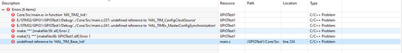

I am using STM controller(STML031K6) first time and I have successfully run led program now I want to use timer (interrupt basis) but facing issues(undefined reference).

please help me to remove this error.
2024-04-03 5:20 AM - edited 2024-04-03 5:27 AM
From your code, I conclude you're using CubeMx code generator tool.
Did you enable TIM2 from the CubeMx GUI or just you did a copy paste of TIM2 configuration from another project?
If you copied it, I suggest you to configure TIM2 in CubeMx as it will activate the define HAL_TIM_MODULE_ENABLED in stm32l0xx_hal_conf.h to include stm32l0xx_hal_tim.h in your project.

2024-04-03 4:58 AM
Sounds like you haven't included the HAL Timer stuff into your Project.

2024-04-03 5:00 AM
Use the code pasting tool </> if dumping source code inline.
Check you have the TIM library source included in the project build.
That hal_stm32l0xx_conf.h calls out the TIM module for inclusion.
2024-04-03 5:07 AM
#include "main.h"
#include "stm32l0xx_hal_tim.h"A nice try for 1st time user ))
But actually you need to configure a timer (or several) in Cube/Configuration view and regenerate code.
All needed library files should be added for you.

2024-04-03 5:28 AM
I am confused to configure "TIM2". I want to make a timer with interrupt basis can You please help me to configure it.
