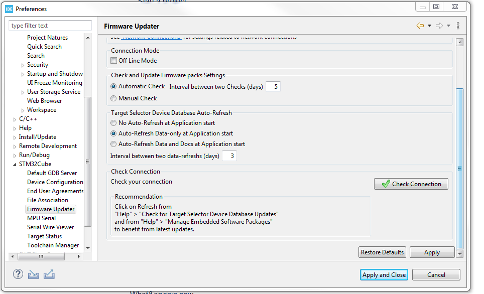

Upon checking connection status in Window-->Preferences-->STM32Cube-->Firmware updater the check connection failure is noticed. I am unable to create any STM32 project as it needs a network connection for downloading the repository.

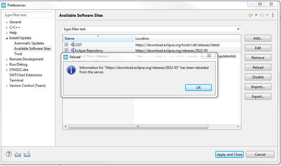

I got one more doubt - I am able to reload in Available Software Sites as shown in attached image, that indicated valid network connection then why connection failure on firmware update page

Your last trial worked. Thanks a lot, man. Please see the attached snippet. I am attaching ide log for you to diagnose further.
