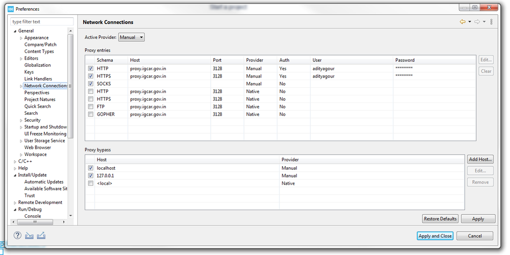

Done appropriate proxy settings in Window-->Preferences-->Network Connections as per https://wiki.st.com/stm32mpu/wiki/How_to_set_up_proxy_and_P2P_Ethernet_connection_with_STM32CubeIDE.

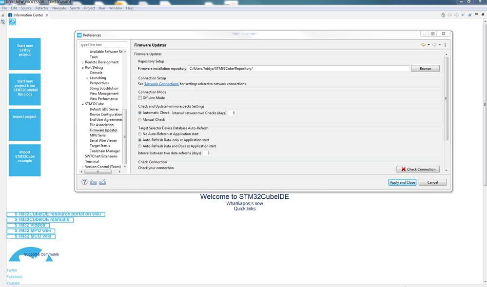

Upon checking connection status in Window-->Preferences-->STM32Cube-->Firmware updater the check connection failure is noticed. I am unable to create any STM32 project as it needs a network connection for downloading the repository.

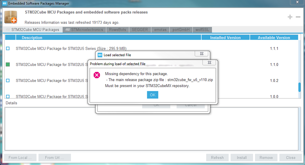

while trying Help -> Manage Embedded Software Packages -> From Local ... i faced the problem mentioned in the attached image. i downloaded the package from https://www.st.com/en/embedded-software/stm32cubeu5.html#get-software

Where did you place the FW package?
I believe the Embedded Software Packages Manager is trying to search for the stm32cube_fw_u5_v110.zip file in C:\Users\USER\STM32Cube\Repository
2022-06-30 2:31 AM
first i placed under C:\Users\Aditya\STM32Cube\Repository it did not allowed then I try to fetch from desktop then one version 1.1.0 was imported but 1.1.1 was not imported.
2022-06-30 2:38 AM
The 1.1.1 is not a stand-alone package, just a patch that's supposed to be applied to the 1.1.0 package. Does it come with some sort of ReadMe.txt to explain how to apply the patch?

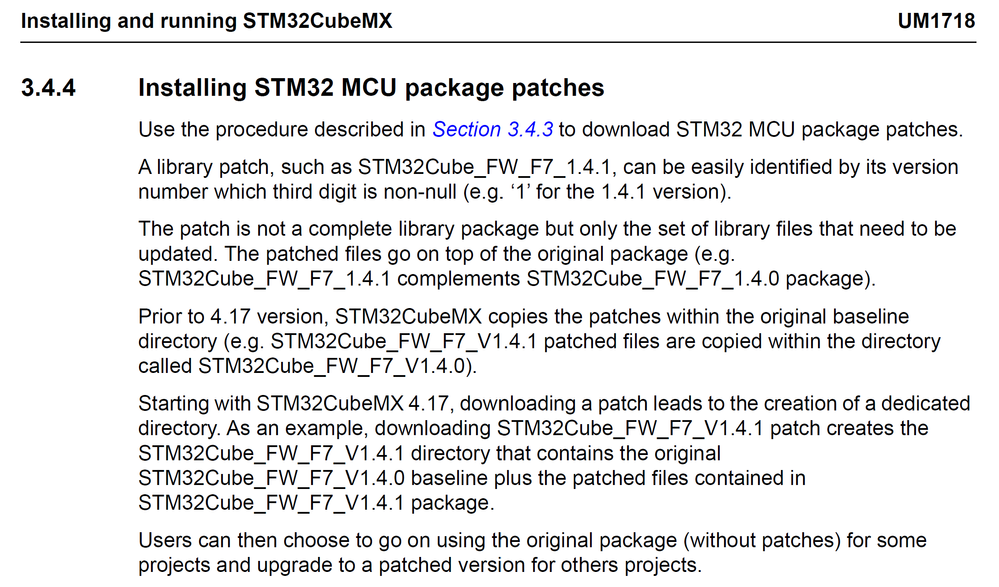

Hi @Markus GIRDLAND , @Agour.1
Can you please follow instruction detailed in the CubeMX UM1718:
Regards,
Aymen.
2022-06-30 3:14 AM
And to be more correct, below the step by step procedure to install the patch:
Let me know your feedback,
Aymen.
2022-06-30 3:53 AM
Thanks a ton Aymen.. it worked..

After Apply and Close, please check again with Preferences > STM32Cube > Firmware Updater / Check Connection whether the connection is recognised.
